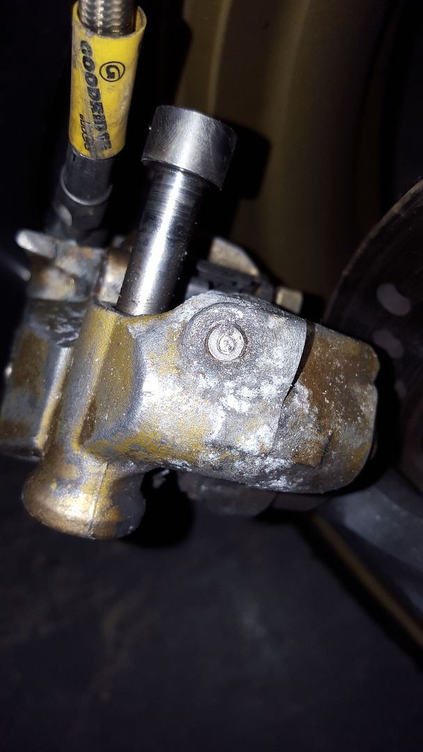

At the end of last year, my brother and I managed to shear the bleed nipples on both his front brake calipers while trying to bleed the brakes.
They both sheared off while trying to tighten them, luckily at the time, they were in far enough that brake fluid wasn't coming out.
So now I'm trying to get them out and replace them.

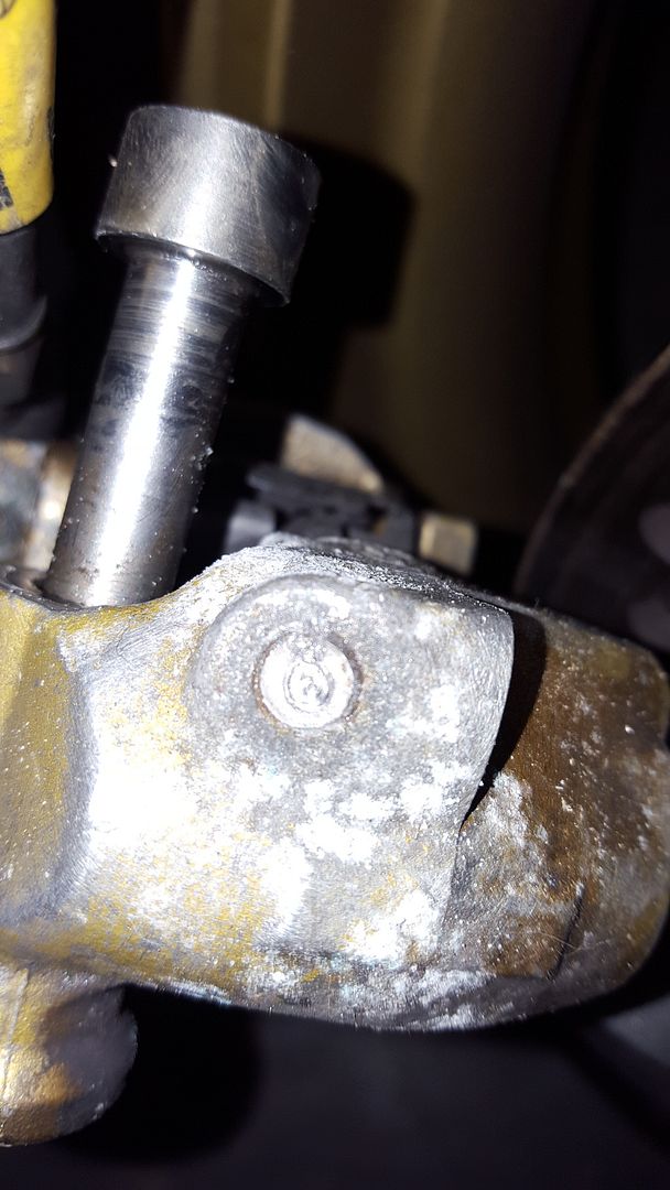

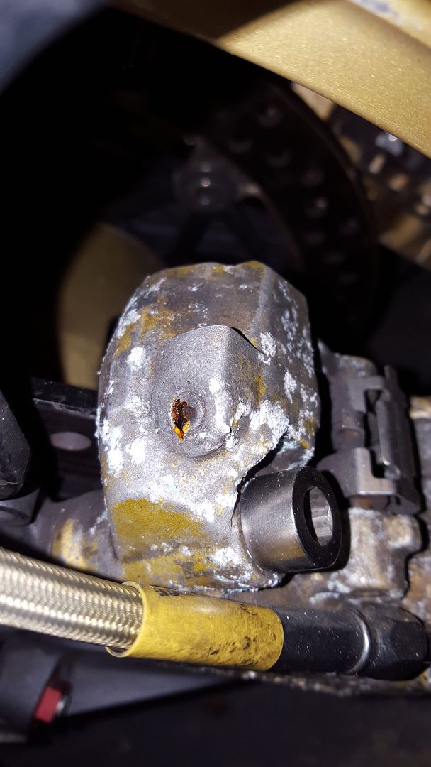

They both sheared the little bolt on top, leaving a little hole visible where the oil would normally come from.
I put a screw / stud extractor in the hole and tightened. It got to the point I couldn't tighten any more and it kept slipping in the tool.
I took it out then tried the next size up, that one didn't screw in as far, but sheared in the hole. I've tried drilling the stud remover but it's very very hard and the drills get nowhere.
Now I'm left with this, so, any ideas on how this can now be removed?:
Before:
After:

A centrepunch will loosen the broken bit of stud extractor, and then you can drill the sheared-off bit out.
Ideally, buy a left-handed drill bit. As the heat from the drill bit builds it sometimes simply locks and undoes the section of nipple.
If not, you can then try a larger broken stud extractor, which is less likely to break.
And don't use aluminium or Ti bleed nipples next time!

As far as I'm aware You can't drill an easy out. You can grind it weld it or smash it and hope it shatters they are so hard.
Should have drilled the nipple out and used a helicoil but it's too late for that now.
Can you take the Pistons out and get at the nipple with a centre punch from the inside?

Spark erosion will sort that but it'll cost more than the caliper is worth unfortunately!!

tony.mon wrote:A centrepunch will loosen the broken bit of stud extractor, and then you can drill the sheared-off bit out.
Tried this, it just blunted and then broke my drills. Bugger.
Watty wrote:Spark erosion will sort that but it'll cost more than the caliper is worth unfortunately!!
Yeah I read about this. Sounds good, but expensive.
Pete.L wrote:As far as I'm aware You can't drill an easy out. You can grind it weld it or smash it and hope it shatters they are so hard.
After some more reading, sounds like I need to be using Carbide drill bits rather than HSS, shame left hand ones are in HSS.
I've just ordered some Carbide bits to see if they work. If not, it's new caliper time.
I don't think I can get to it from the inside, it's at a funny angle.

Miztaziggy wrote: After some more reading, sounds like I need to be using Carbide drill bits rather than HSS, shame left hand ones are in HSS.
Why bother trying to buy left handed Carbide or HSS, just buy normal handed drills and re-grind them the opposite way, It's not difficult, I've done it loads of times, All you have to do is re-grind the cutting edge and re-grind the rake the other way round from normal, I'm sure if you can't do it you'll know someone who can do it for you, after all you only need a grinder.
Some heat might help you to soften the stud extractor, if you know anyone with a Tig welding set, they can put a very small tungsten tip in, say 1.00mm or 1.5mm and heat it up for you using low amps so it only heats it up and doesn't try to weld it, worth a try :thumbup:
By the way what is the original material of the damaged bleed nipple :?:
Without seeing it it's difficult to say, but another possibility is use a dremel or a grinder with a fine cutting disc and cut a slot in the top, bit like a screw driver head slot, yes you might cut the ally as well, but does that matter, then you can use a impact driver, if that doesn't work you should be able to punch it round using the sides of the slot :thumbup:
