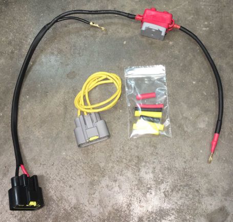

FH012 or FH020 MOSFET RR , couple of feet of good wire in 12ga and 14ga, 40 amp circuit breaker, heavy duty terminals for the battery connections, some heat shrink tubing and 2 Furukawa 250 QLW Series R&R Connectors.

The OEM or pattern aftermarket Regulator / Rectifier which is diode based will fail...today, tomorrow, next year. Likely taking out at least the battery if not wiring harness and gauge.
The remedy is: Replace with a Shindengen FH020AA or FH012AA MOSFET RR using Furukawa 250 QLW Series R&R Connectors, good tined wire, 35-40 amp fuse or breaker, and 1mm thick heavy solid brass ring terminals sized to fit your specific battery terminals
If you have the tools and proper wire on hand, the connectors and terminals, the circuit breaker (vice having to buy three rolls to get the proper wire, packages of terminals, proper crimping tools) you can piece together what you need for about 69 GBP. for just the items needed.
A custom made kit with wiring made just for the VTR is $100 GBP, and its ready to install.
A General fit kit you coil up extra wire, but that has all the good components and good trusted workmanship (not all crimping is the same) is about 129.GBP.
So worst case to do it the better way, Under 130 GBP and never have to worry about it again :thumbup:
EDIT: Sorry, I forgot the thief like prices to get stuff shipped to you blokes..... that adds like 42 GBP to the cost when having a kit or supplies shipped to you from a US seller.
EDIT 2: Damned If that did not read like a door to door vacuum salesman... Not my intent... if you want to make your own kit and need help with how or parts source...ask, happy to help
