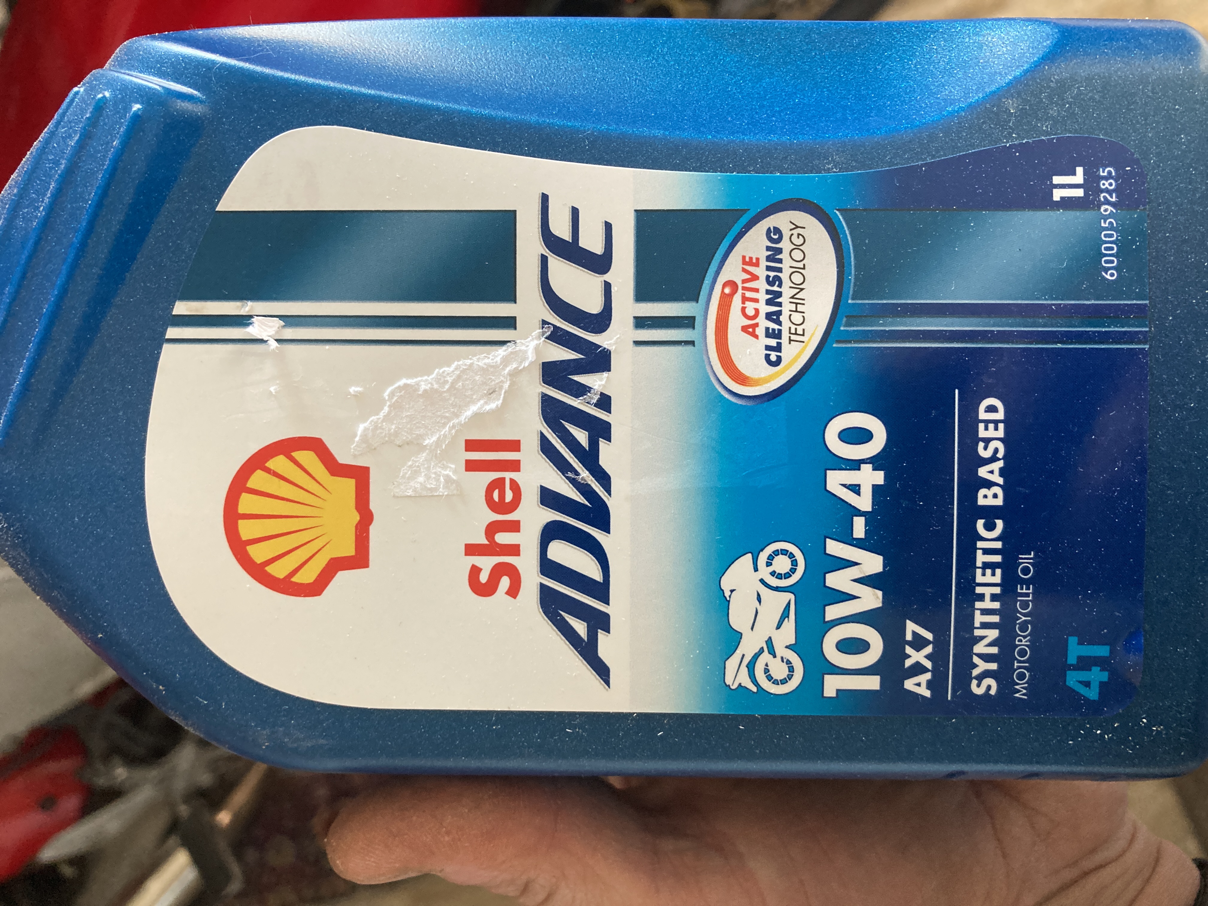

Are you using mineral oil or fully synthetic as fully synthetic can cause issues
Tombola89
Posts: 10
Joined: Fri Sep 17, 2021 8:23 am
Re: Creepy clutch
Post by Tombola89 »
I’m using this oil, it’s semi synthetic. I had all the plates out and gave them a clean aswell.
I did this because when I first got the bike and tried rebleeding etc I thought maybe the plates could of been contaminated.
Re: Creepy clutch
Could be the issue. I have a fj1200 with the same symptoms and have done the same as you cleaning slave cylinder and re bleeding The FJ forum recommended mineral oil as synthetic oils have caused some bikes issues. I’m going to change mine at some point as I’ve tried everything else.
