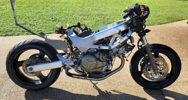

Hi guys,
New to the forum and the VTR.
So I've just had a bit of a worst case scenario happen. :crazy:
My first 2005 VTR1000F purchase. So I've picked up the bike and was on my way back home, 8 hour trip but only made it an hour out and the bike died. Running smoothly prior to that and turned off just like a kill switch.
I checked fuses and cranked it over a dozen times until battery went flat. Had a new battery installed road side and nothing.
Next day transported it to the nearest Honda shop. They charged me an hours labour and said the ICM and converter are dead, the bike has no spark. They used another VTR there and could swap parts. Isn't the Hiss system ICM specific? So if they tried the other bikes ICM it wouldn't operate either?
I'm a little sceptical of the short time spent diagnosing. From looking at the manual I would expect it to take longer to go through each component.
Any help would be much appreciated. I need to get it home to start going over it.

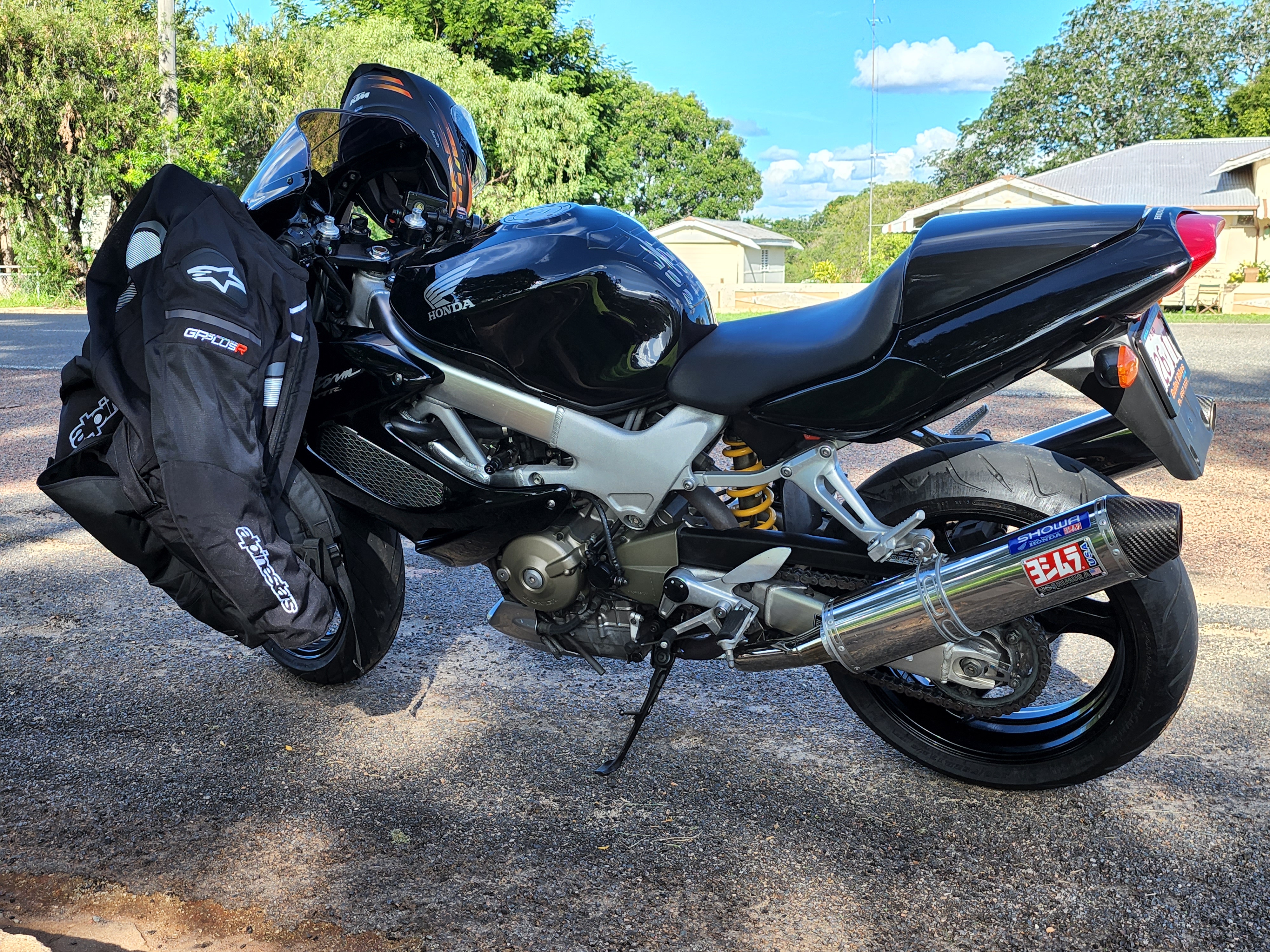

Hope it works out ok for you mate, looks a nice clean bike

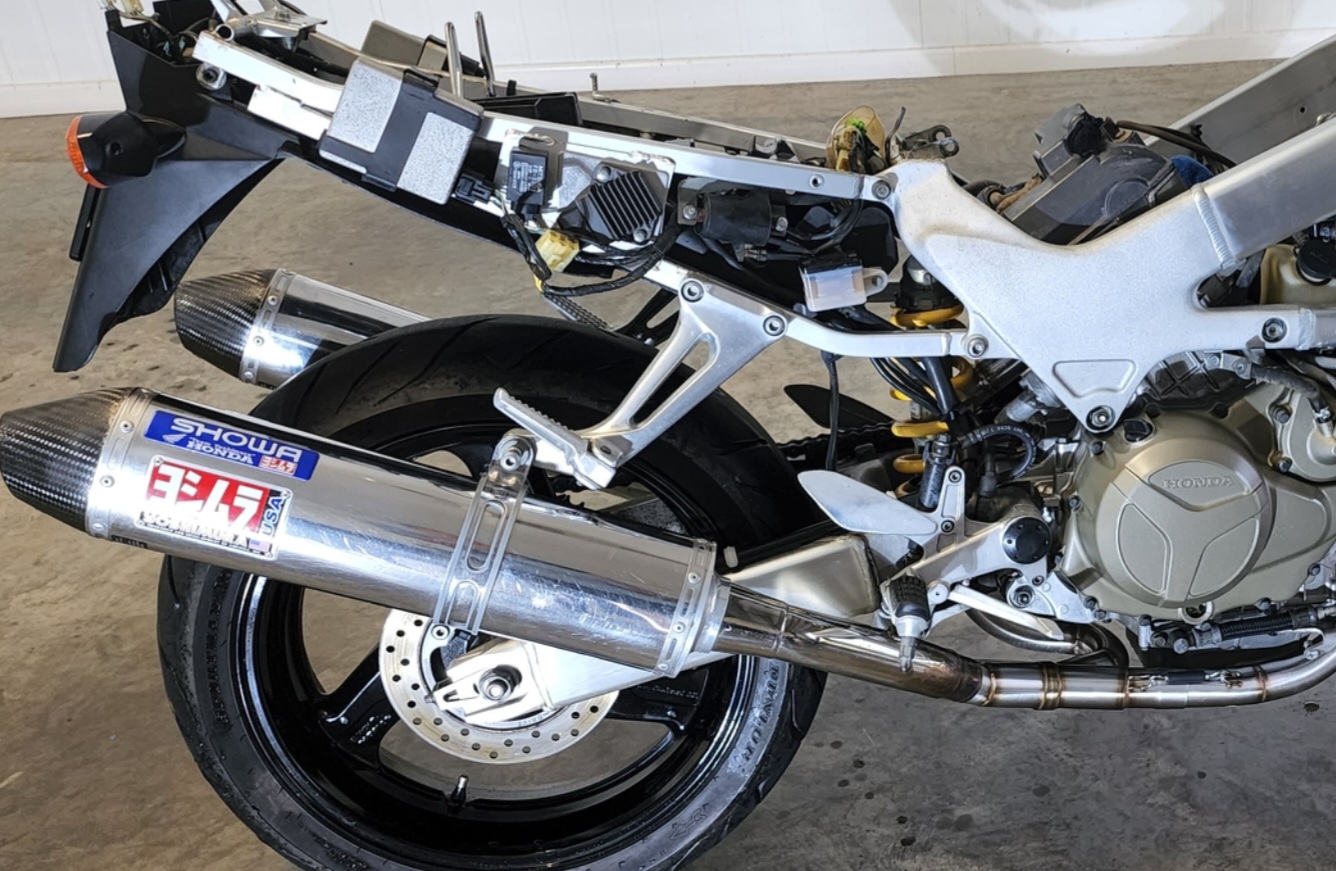

Thanks guys for the suggestions. I ended up getting it home and tracking it down to the spark converter. The alloy cdi on the right. I could feel heat on the back of it with the key on in only a few minutes. I thought that was strange. Found one cheap from the wreckers, plugged it in and walla.

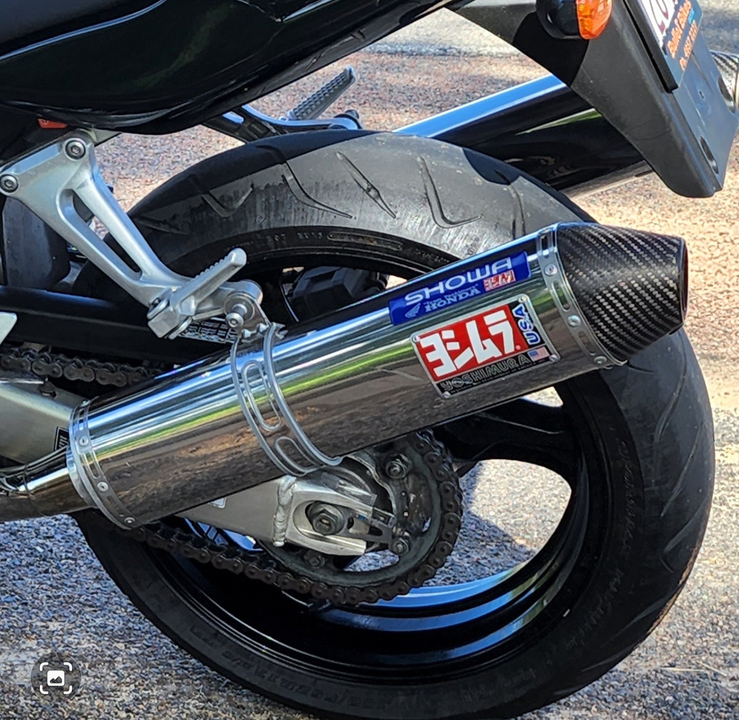

Does anyone know the model of this Yoshi system?
