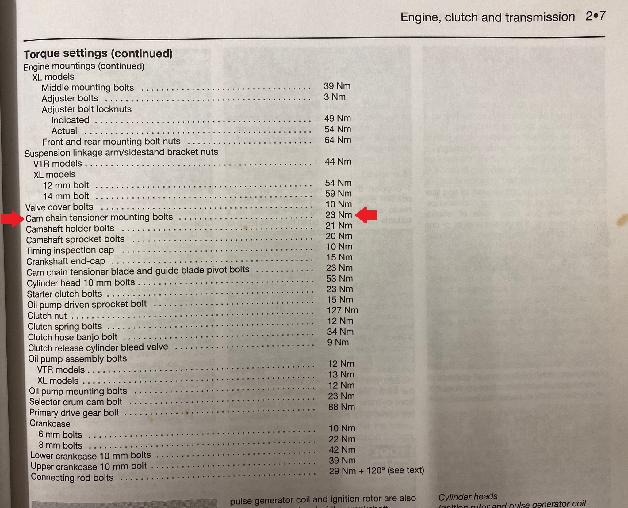

What torque for the mounting bolts pls? Haynes says 23Nm for the ‘blade and guide blade pivot bolts’ I don’t know if this is the same!?

Torque setting from Haynes. Still no clue?

Setting the up and down movement of the cam chain between the two cam sprockets at 6mm should be okay.
The reason there is very little play in the cam chain with the standard CCT's still fitted is simply due to the standard CCT's self adjust somewhat, so that is normal.
The reason old standard CCT in your photo appears to be longer than the new manual CCT is because it is fully extended, when fitted in the engine the plunger is retracted a fair bit.
You're on the wrong page :wink: :shh:
It is 23Nm according to the Haynes manual, although I must admit I just tighten mine up to what I feel is correct through experience I guess.

Thanks. I think we’ve got a slightly different Haynes as my 2.7 doesn’t look like that 8O

Donut 77 wrote: Mon Mar 20, 2023 3:59 pm Thanks. I think we’ve got a slightly different Haynes as my 2.7 doesn’t look like that 8
Well I never, I agree your manual is different than mine :crazy:
