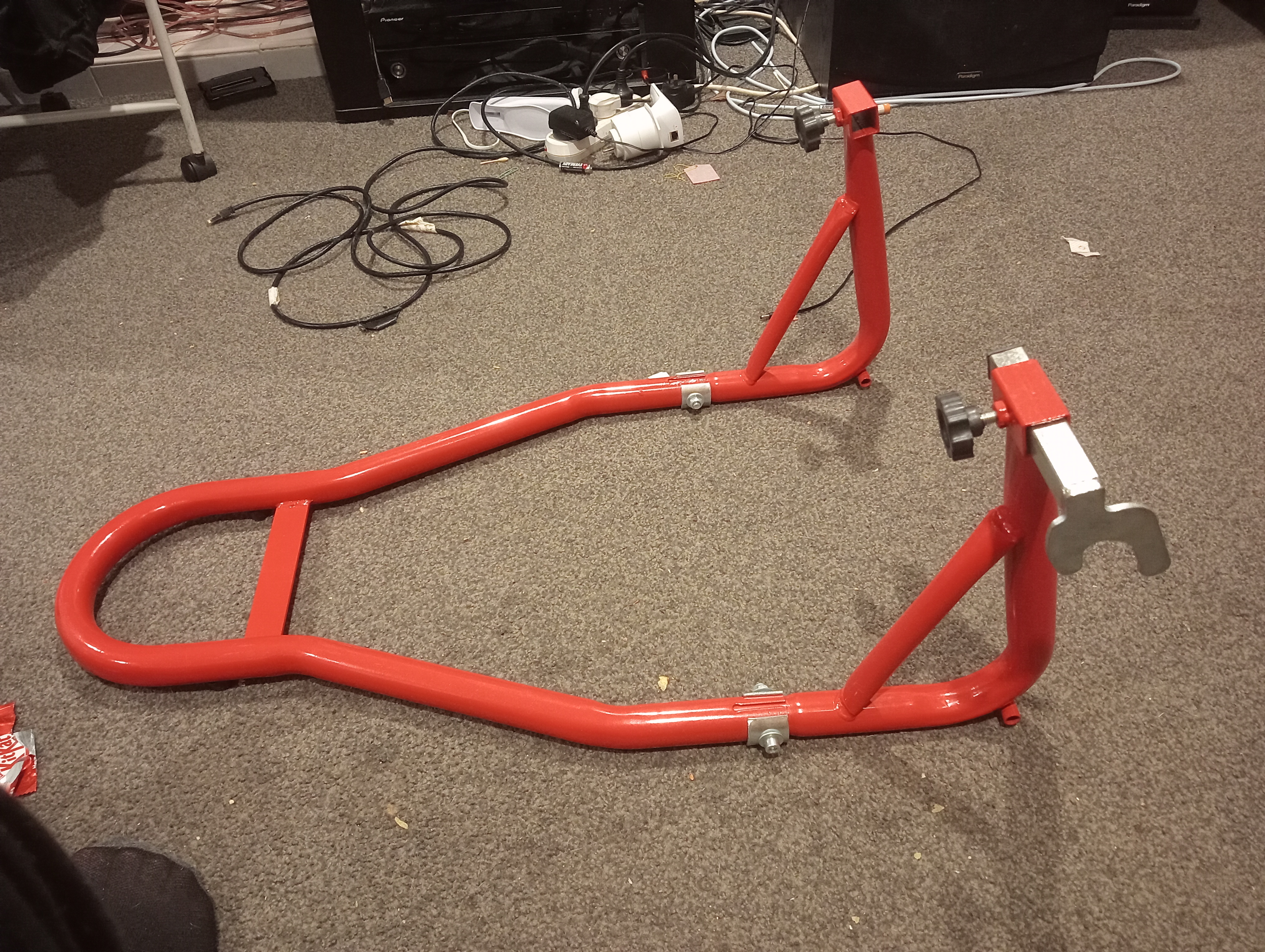

Hi first post
I got get my written of vtr 1000
Home with flat rear tire pushing
It going try pump it up
I have qwestion how use a padlock
Stand with no spools on swingarm
Don't think can fit them
As my stand got square tube
Extensions it just slide off.

Re: Newbie bike stand qweston
You can fit bobbins...
Some have had a block welded on to the bottom, drilled & tapped.
Some have used Rivinuts into the swingarm & screwed in the bobbins.
Some have just drilled the swingarm & tapped the hole to size & fitted.
Some use a threaded bar through the spindle with bobbins on the end...Ok for chain lube/adjustment but you cant remove the wheel with this type.
Finally if you can find or make some adapters/hooks that go on the spindle...Again Ok for chain lube/adjustment but you cant remove the wheel with this type.
Or as Chris said get some replacement cups for your stand.

That's me I drilled and tapped the holes 25mm up from the bottom of the swingarm and 107mm in from the backend. Swingarm thickness is approximately 4mm thick. I used bobbins with 8mm diameter thread bolts, fine thread is best,
Me, too. They even put up with sitting in the bike while it's on the stand, so plenty strong enough. +1 for the M8 fine thread.
