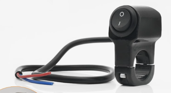

Hi guys, im trying to install my new manual headlight switch on my motorbike but im novice at wiring so i need help. I ordered following switch

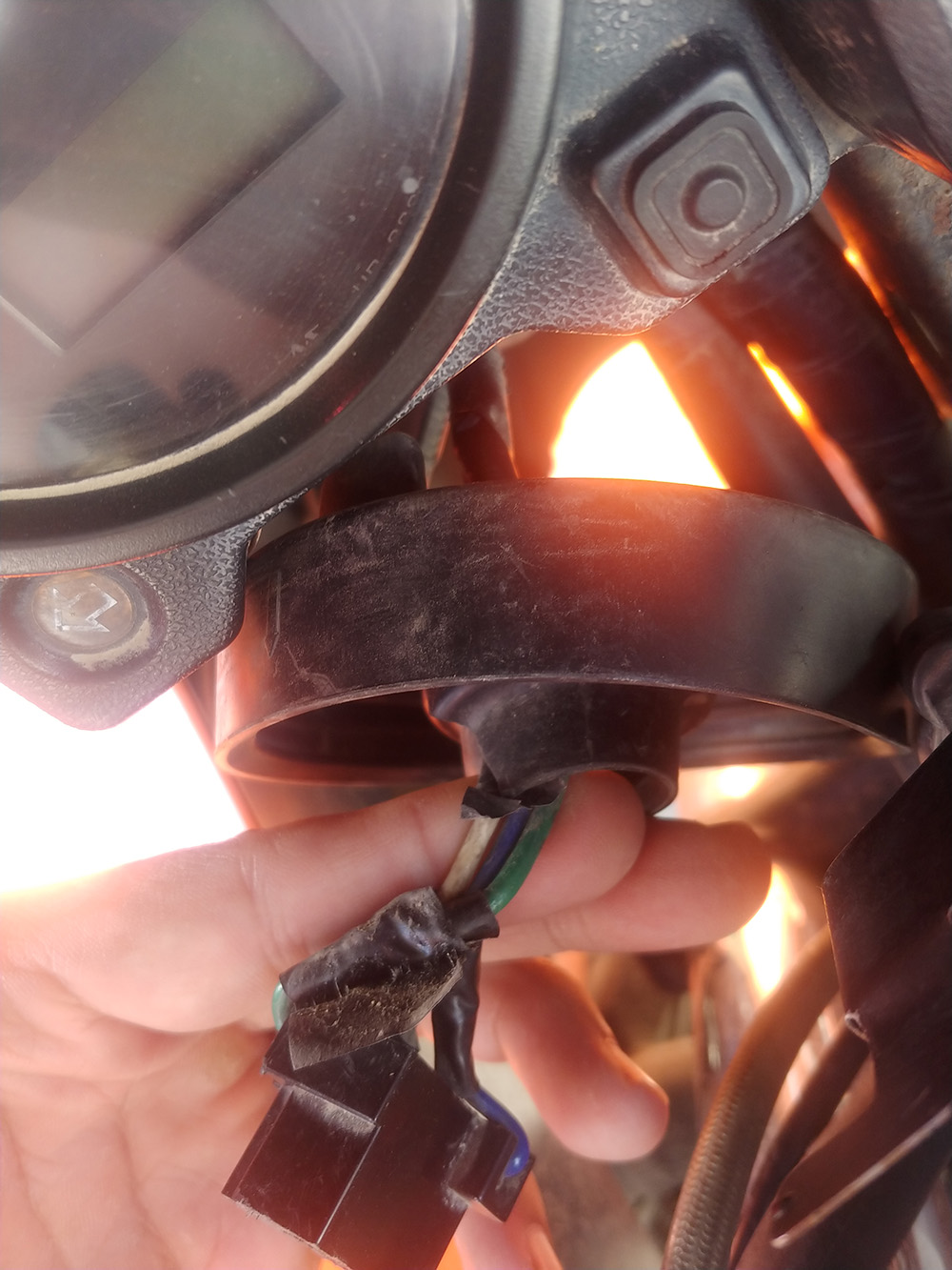

And i have 3 wires from headlight
which one is plus wire? and can i install 2 wires switch on 3 wires light?

If you need to switch the front lights on/off with that switch, it'd theoretically work to
- cut the green wire at the bulb plug
- solder one end to red and the other to blue of your switch
That switches off the ground connection for the bulb, so neither regular nor high beam should work.
BUT: That switch is surely not rated for the required amperage and also the tiny cables will result in a high voltage loss (i.e. "darker" lights when switched on.)

MK_WF wrote: Sat Aug 31, 2024 5:09 pm If you need to switch the front lights on/off with that switch, it'd theoretically work to
Thank you, i soldered white wire for low beam and it works like charm :D
