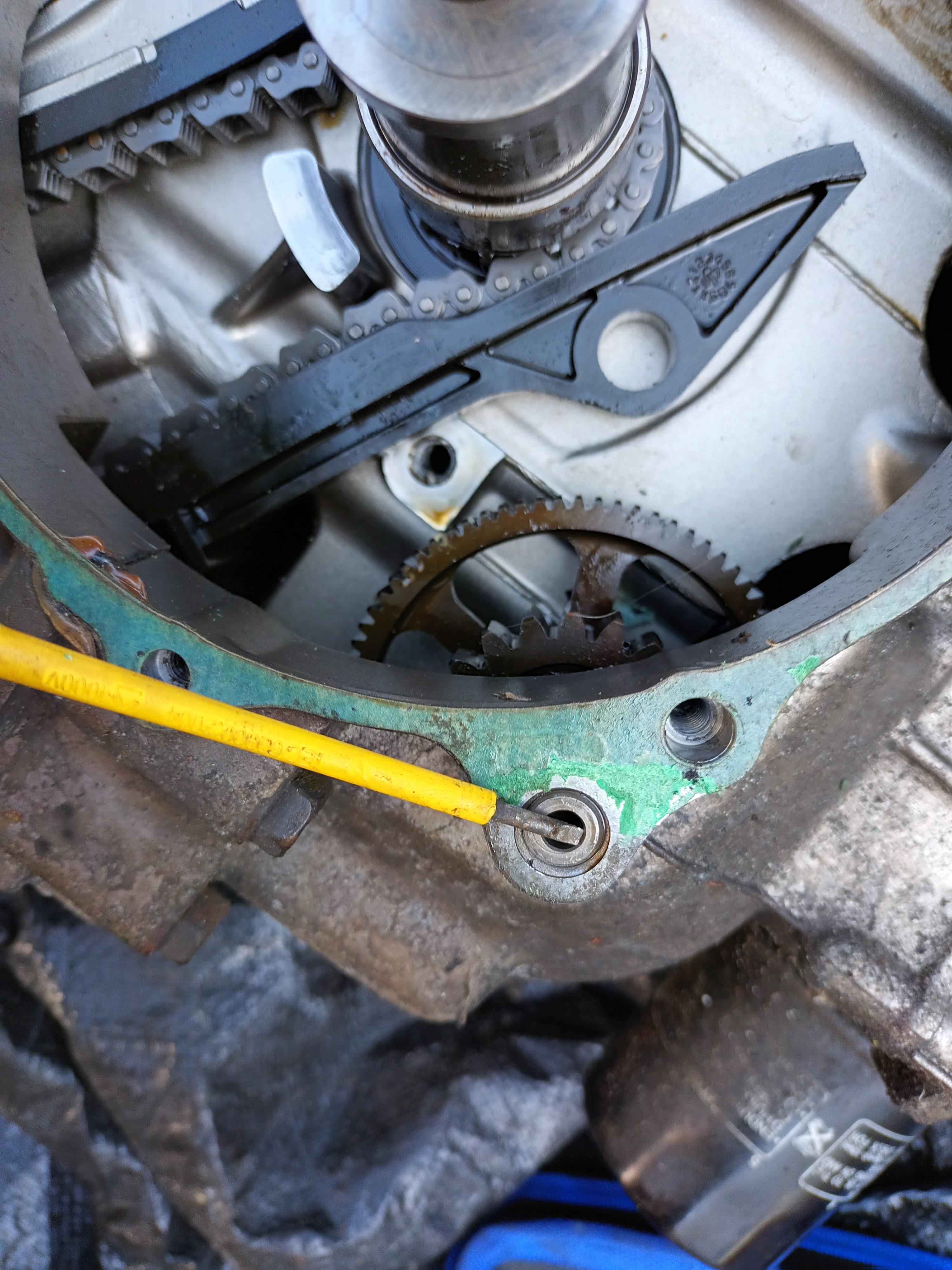

do you know what the metal rod is for bottom left as you look at the stator
Re: help help i need an answer
northmanuk wrote: Tue Sep 06, 2022 4:40 pm re hammer chisel no lump hammer 8O
i have just ordered another casing
Do you mean the spindle for the starter gear :?:
As pointed out with a screwdriver in Mac's photo below:
That spindle can only be removed with a magnet.
